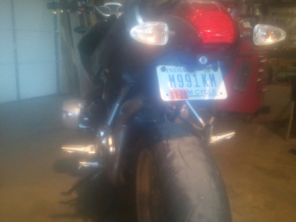

Decided to make my own thread after threadjacking for a while on the 'one more exhaust' thread.
Pieces I started with, 2 2" 45 deg, 2' 2.5" straight, one 90 deg 2.5", 2 180 deg 2.5", two 1' sections of 2" perforated pipe, fiberglass muffler packing, half sheet 16 gauge brushed stainless
So far added 1' of 3" tubing, thermal barrier, possibly use exhaust wrap
All metal is 304 stainless and all bends are mandrel
R1200R Exhaust work in progress - YouTube
So far I have the tubing ran to where it is in the video and took this morning to cut a 3" tube in half longways, cut some 3"x12" strips of the sheet, and disassembled the rear to the frame. Next step is welding the muffler shell together and working on the ends and tip. Also have to relocate the seat release and finalize how I am mounting the muffler and plate.

Obviously way too long and hanging too low but gives an idea of the direction. Still need to move the seat lock and the license plate mounts. Also not using this shell, the sheet is too thin and can't get enough heat into the tubing without warping.... :mad: Now the wait for more tubing in the mail

Ok, finally got back out to work on it. Good news is I am getting close and I have figured out all my problems except what the tip should look like.
1. Put another easy turn in the pipe to get it tucked up closer underneath
2. Cut out the thin sheet from picture before and had to clean up the edges of the tubing sides (make them true ready to weld) Still need finished welded. It just aggressively tacked together now.
3. Cut the mount for the seat lock out and devised a plan to move it.
4. Brainstormed and cussed about intake, think I have a plan for it now though.. I don't like the air filter or where it is.
5. Cut out both ends from sheet of stainless and got a 2" hole cut in the center for tip/exit. Other end is getting plasma treatment to cut out a ring to mount another end piece via rivets so I can re pack later.

Ok got a lot done on the bike today, was hoping to get it done but no luck. Thought I had a video of it running on the phone but went to upload and it was like .5 seconds. The only thing left to finish is heat shielding, mount (failed attempt today), license plate and light.
This is what I was meaning I don't think I got a pic of it after the plasma cutter
Ok so this is it, it's all finish welded
Realized I didn't get a side shot.. It sounds pretty good, little quieter than I was hoping. The tone is really good, I will have to make a video and check it this time. It will probably get a little louder after I burn out some packing. I tried it with no packing just holding it and it was a little raspy.

I am ready to be done also. Next on the agenda is figuring out the heat shielding.. I'm thinking I will use the woven material underneath the tail and make shields out of sheet aluminum. The shields will be suspended around half inch above tubing and muffler via washers and rivets. unfortunately, I can't rush it too much because I want it to be as close to perfect as I can manage. I still have a couple days until I can work on it again.
