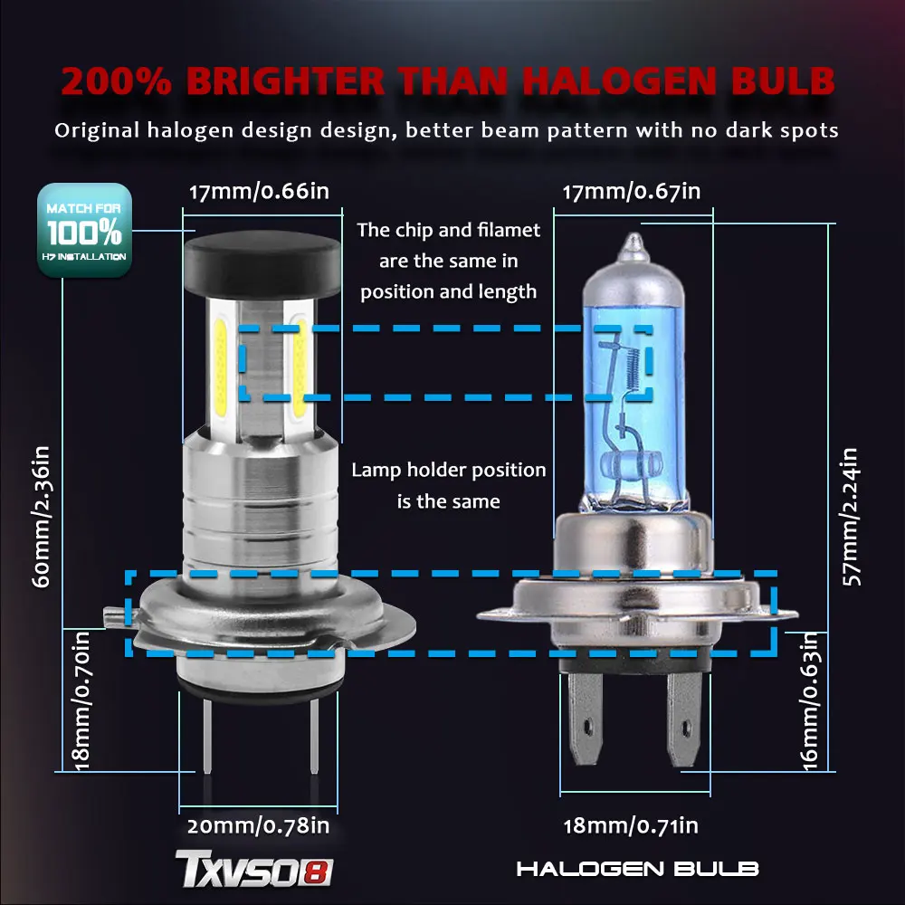

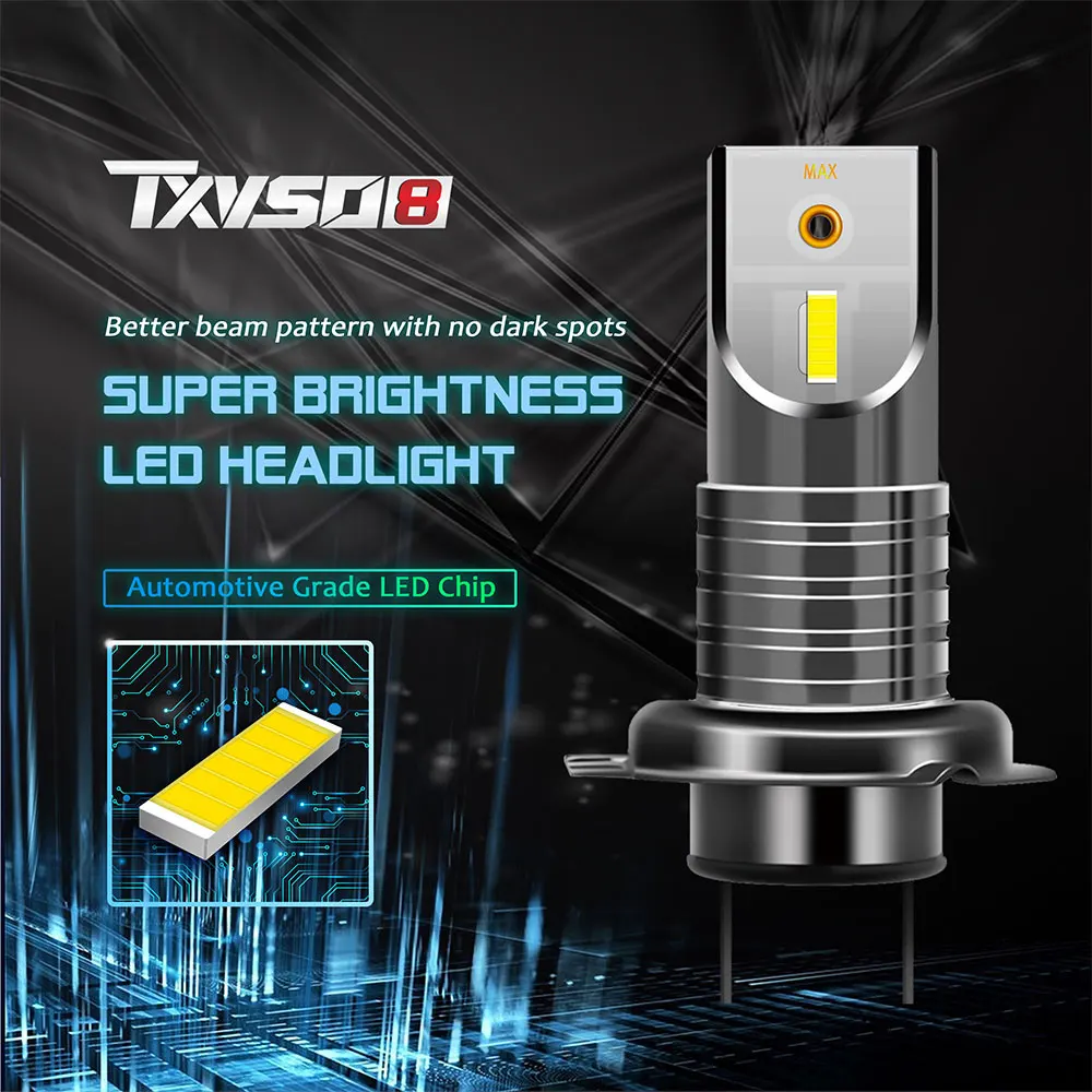

hi everyone,
if one installed a 50W / lamp miniLED kit similar in size to H7 halogen and with passive dissipation, could the Canbus error and resistor installation be avoided? possible other issues?
I found those on Aliexpress
waiting for you comments,
thx
bye
Electrically, either will work without error, I’d say - close enough to 55W to not trigger an error, so no resistor required.
Beam pattern is always an issue given the LEDs don’t exactly match the halogen filament dimensions. 6000k light temperature is very white (verging on blueish) which doesn’t suit everyone’s eyes. Without a heat sink, I wonder how much heat they’ll generate and how this will affect the reflector.
Not worth messing with that IMO. The light pattern would be all wrong anyway. Plus you'd be adding a ton of heat where it wasn't designed to be (inside the plastic housing, full of wires, rather than inside the bulb housing). I just put coated bulbs for a whiter light (to more or less match the middle LEDs), and called it a day. But if you need to ride at night, I'd probably leave it stock, as the coating reduces output, as expected. Good luck.
would that mean adding more heat than (super-)halogen like Philips diamond, in your opinion?
Read my post man. Heat inside where the bulb sits, is obviously fine. But probably not outside of it, where the wiring/connector is. But do whatever the hell you want.

I wouldn’t be so certain about the reflector being impervious to excess heat.

My thoughts were probably not clear, but I am still not getting where I have been rude.
However, my "noob" idea is simple.
Halogen lamps like Philips Diamond/Xtreme Vision are working fine. They for sure produce inside the bulb housing (and for heat conduction possibly inside the plastic housing) much more heat than standard ones. Can a 50W Led with passive dissipation produce even more heat, and therefore be more dangerous than super-halogen?
Any contribution is welcome.
